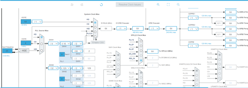

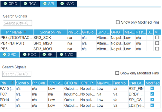

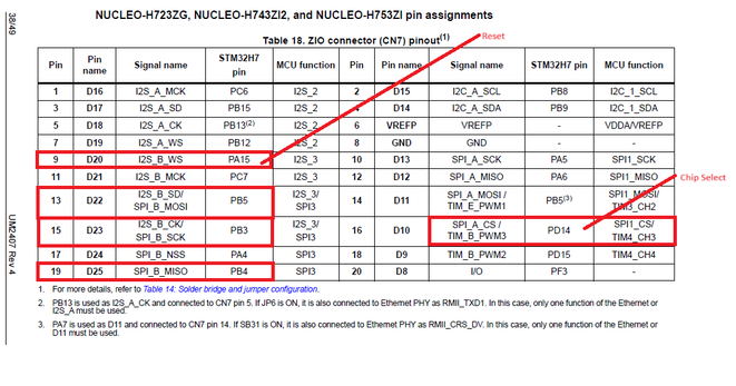

Here is how I am connecting wires in both cases. I don't need to change the wiring or schematic. When uploading through arduino my adc works fine. In both cases I am using SPI3
Below is the CubeIDE pin config
