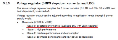

1- STM32H745I-DISCO board is configured in SMPS by HW. So you need first to check if you set SMPS as power supply in the RCC.
2- In SMPS configuration, you cannot exceed 400MHz at VOS1 as VOS0 is available only with LDO.
From the datasheet:
3- Becarefull, there is an issue with the latest version of CubeMx 6.13.0 with the power config. See these threads:
Hope that helps.
