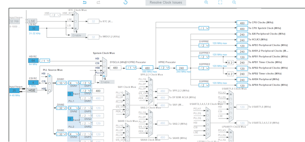

Hi all, I have already searched on the forms and in general did not find an answer to my problem, I will be very grateful to you for help.
I need to create an output signal with a frequency of 100 Mhz as CLK in STM32H745. I used the Discovery Boards (STM32H745I-DISCO STM32H750B-DK) for the test.
1. I used timers with PWM and adjusted the ABM timer clock for 220 MHz, set up pre-scaler and counter period
But I achieve only 50 Mhz a clock as a maximum, with settings for 100 Mhz there is nothing at the output for CLK. To detect the clock I use PicOscope6404D (Bandwidth 500 Mhz).

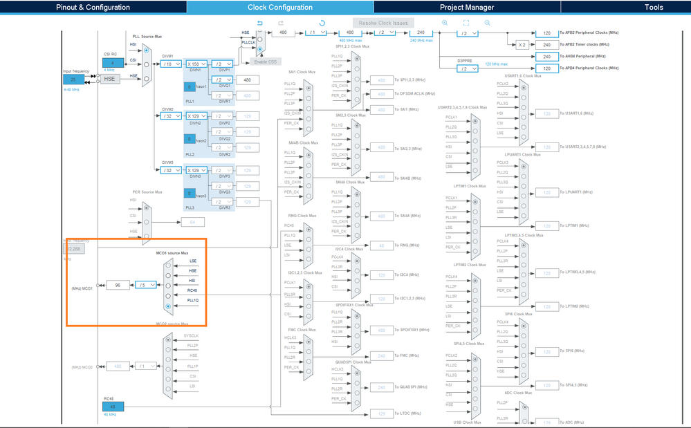

2. I used as output ch A8 and adjusted A8 for RCC_MCO_1
I used the next settings but received the same result as for Timers not more than 50 MHz. Can you explain why I have this limitation (because the device settings show me that I can reach 100 Mhz but in real not )?
3. Finally I used the PA8 HRTIM_CHB2 timer and received high and very unstable frequency with very low amplitude. Do you how I can make a stable frequency and increase amplitude from HRTIM_CHB2?
2024-08-22 6:37 AM - edited 2024-08-22 6:38 AM
HAL_RCC_MCOConfig(RCC_MCO1, RCC_MCO1SOURCE_SYSCLK, RCC_MCODIV_1);
replace to
HAL_RCC_MCOConfig(RCC_MCO1, RCC_MCO1SOURCE_PLL1QCLK, RCC_MCODIV_5);

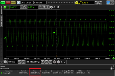

Hello @Ronil ,
I kindly requested an internal colleague to do the test on a Nucleo H753 with KEYSIGHT DSO9254A oscilloscope. 100MHz is output on the MCO pin like shown in this oscillo screenshot:
So you need to use an adequate oscilloscope and probes for these high frequencies.

__HAL_RCC_PLLCLKOUT_ENABLE(RCC_PLL1_DIVQ);
HAL_RCC_MCOConfig(RCC_MCO1, RCC_MCO1SOURCE_PLL1QCLK, RCC_MCODIV_3);
