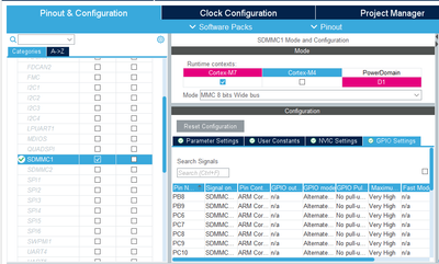

SDMMC CLK
RCC
SDMMC

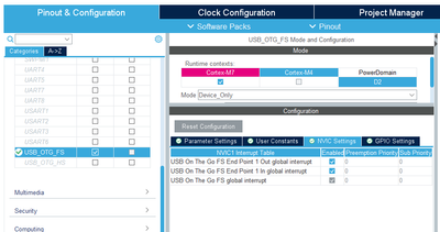

USB_OTG_FS configuration

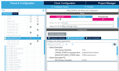

in middle firmware
All these configurations were applied in the CM7 core.

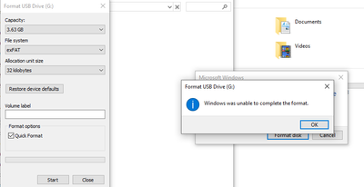

When we attempt to format the disk from the host system (e.g., Windows), the operation fails with an error

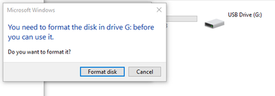

If we added these two function the disk not showing the PC we are getting like this
Please provide a solution for this issue. I have also attached the relevant firmware configurations for reference.

Hi @sivani
If still having the same issue, update latest version of CubeMX and Cube FW H7.
Changing features involves modifying the USB device descriptor. Each time we change the device descriptor, we may need to reinstall the USB device : uninstall the USB device from the Windows Device Manager and re-plug the USB cable. During this operation, the USB host keeps new information in its registry. Also, changing PID can solve such issue.
