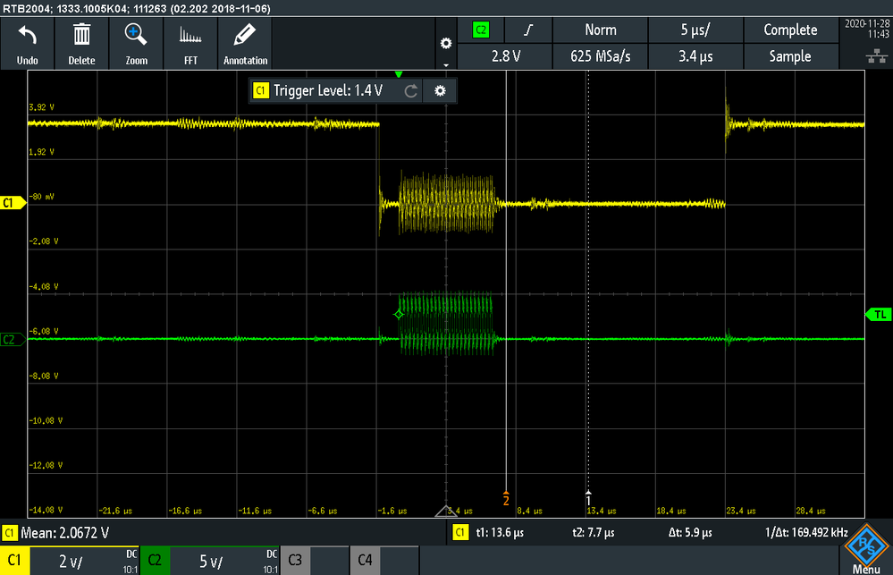

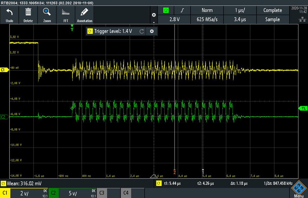

I'm working on a board with STM32H745. The mcu has to interface with an external ADC
(LTC2335-16) to permit a max sample rate of 1M/s (during software develop 20KHz see images).
So, i've decide to use LPTIM2 to generate the 1MHz signal (50% duty) to generate the
start conversion for ADC (positive edge). After 500nsec the converted data is ready to
get out the 3 bytes read (see the attached images). So I configure the SPI with transmit and
receive DMA with the synchronization event for DMA TX with the falling edge of LPTIM2 signal.
Here is the peripheral initialization software.

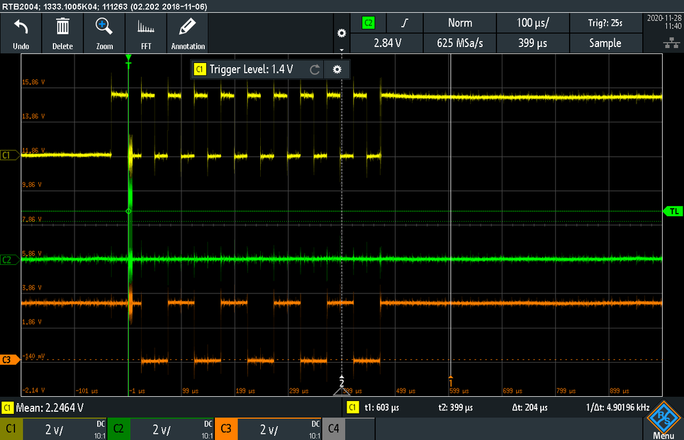

As you can see only the first SPI packet exit on falling edge and no more other.

2020-11-28 3:54 PM
Break it down into smaller steps. Make sure your HAL_SPI_TransmitReceive_DMA calls work correctly on their own, then try to integrate them into the system. Ensure HAL_SPI_TransmitReceive_DMA returns HAL_OK as opposed to an error code.
Calling anything but the most trivial ISRs at 1 MHz is going to be a nonstarter. You can probably get away with 20 kHz.
For development, I'd slow things down even more so your scope waveforms look more square.
