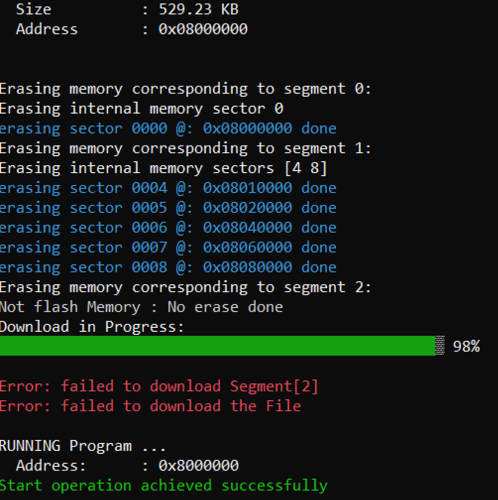

2023-02-14 7:25 AM
I use CLI for flash F469 and same hex file flashed over SWD without error produce over DFU this. is this know issue ? Seems code is ok after both loads.
2023-02-14 9:36 AM
I test HEX and ELF file, and seems here linker generate section , but same file dont produce error if -c SWD is used.

:00000001FFand i dont understand why this section is in . Maybe my linker file need add somethink i use CCMRAM for some arrays. now is defined as
/* Memories definition */
MEMORY
FLASH0 (rx) : ORIGIN = 0x08000000, LENGTH = 16K /* FL1 zatial isr */
CCMRAM (xrw) : ORIGIN = 0x10000000, LENGTH = 64K
RAM (xrw) : ORIGIN = 0x20000000, LENGTH = 320K
FLASH (rx) : ORIGIN = 0x8010000, LENGTH = 1984K /* reserve EEPROM sec 1 2 3 used only 2 3*/

2023-02-14 9:02 AM
Where's the data going?
SRAM at 0x20000000. CCMRAM at 0x10000000
There shouldn't be any of that in the .ELF file / sections, as the startup.s code should be copying initialization data out of Internal FLASH
What other sections is the DFU file describing?
MEMORY
/* Sections */
SECTIONS
/* Added MM */
.ccmram :
. = ALIGN(4);
_sccmram = .; /* create a global symbol at ccmram start */
*(.ccmram)
*(.ccmram*)
. = ALIGN(4);
_eccmram = .; /* create a global symbol at ccmram end */
} >CCMRAM
/* The startup code into "FLASH" Rom type memory */
.isr_vector :
. = ALIGN(4);
KEEP(*(.isr_vector)) /* Startup code */
. = ALIGN(4);
} >FLASH0
... rest no changes
