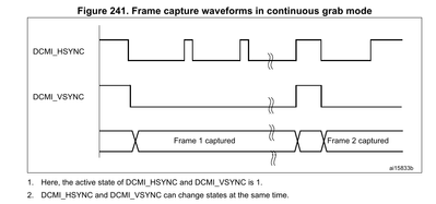

>DCMI to read 10-bit
Should work, VSYNC and HSYNC together to a pin : hi->lo starts capture (= "frame" for video)

My data has frames that are easy to catch and are not long (around 1kB) and are easy to process from assemble.
Normally I could connect something to DCMI_HSYNC, but I use LCD_VSYNC on pin PA4 (I have VGA output) and I don't have an alternative to DCMI_HSYNC on another pin.
My data is similar to the DCMI interface - 8 bit + clk + hsync + vsync and it would be possible to process it using all pins, if not PA4. Unless there is a way to move LCD_VSYNC or DCMI_HSYNC to a different pin than PA4

So you cannot enable the DCMI at all, because PA4 used for LCD and no more avail for DCMI .
