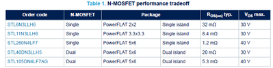

For Port 2, I recommend TCPP02-M18 because STM32G0B1 can manage 2 ports.
Key parameters of load switch selection are :
Find below a list of possible ST N-MOSFET :
On STM32 example, D+ and D- lines are connected to STM32 data lines for illustration.

2025-05-12 4:43 AM
Dear Antonio,
