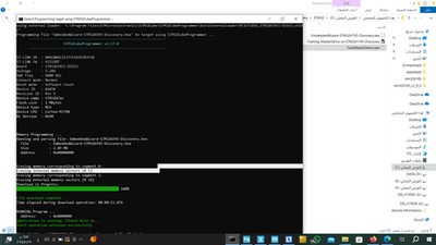

Once I did that, it worked, and the interfaces appeared, allowing me to modify and upload them. However, when I added the USB host initialization, the screen froze without me adding any line of code. After that, the microcontroller refused to accept any code. I had to use the reset button with CubeProgrammer in power-down mode to restore it before it could take the code again.

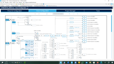

"For your information, I have modified many of the frequency values within the settings. I even raised the input frequency to a value of 48."

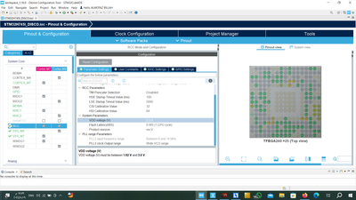

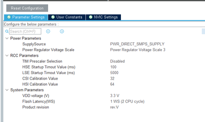

Again what is the power config you set? SMPS or LDO?

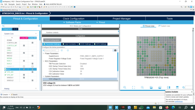

The power config needs to be set to SMPS as STM32H745 Discovery is configured in SMPS by hardware.
Show you RCC config from this CubeMx window:
