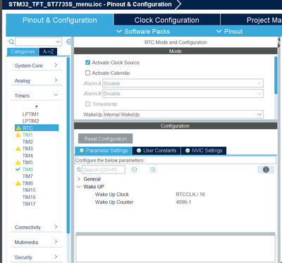

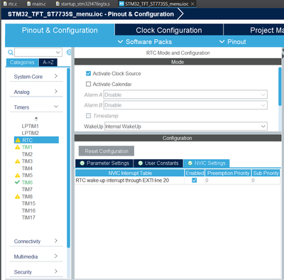

Down below are my project settings:

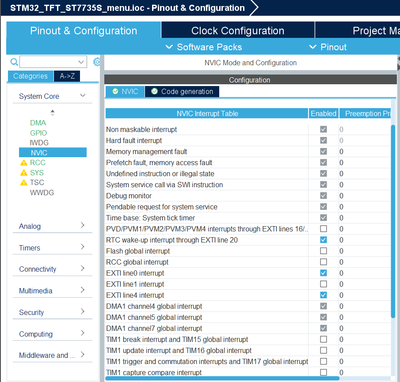

@Saket_Om thanks, I have it in my project, the LD2 available on the L476RG, should toggle, when the
HAL_RTCEx_WakeUpTimerEventCallback
is entered, but it doesn't so I guess the microcontroller isn’t waking up properly from sleep mode.

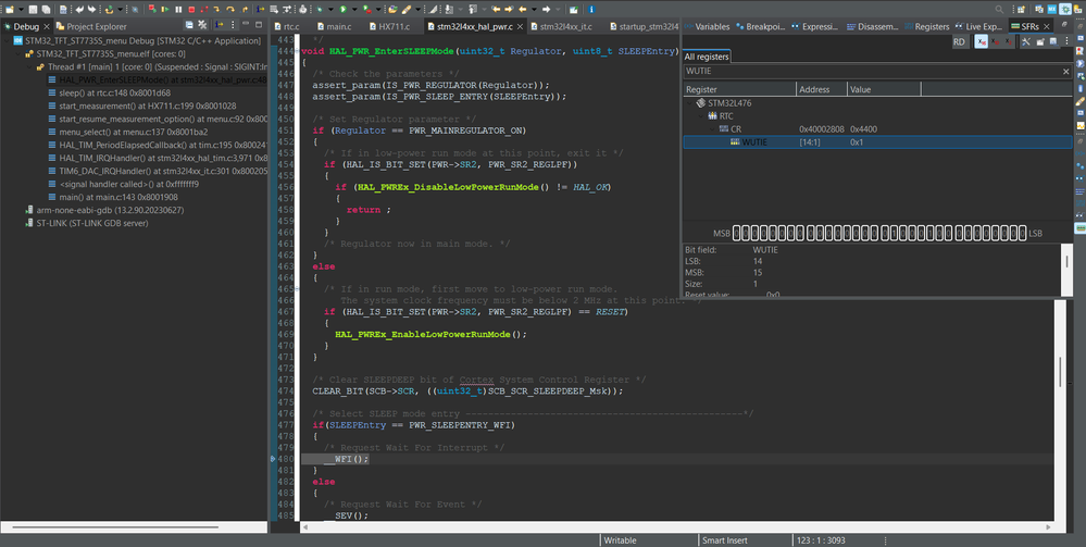

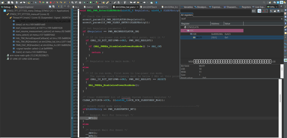

I tried observing the relevant registers during a debugging session.

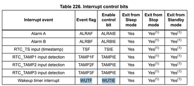

According to the reference manual, when the RTC wake-up counter reaches zero, the WUTF flag (Wake-Up Timer Flag) should be set in the RTC_ISR register
And it is
As well as the WUTIE flag:

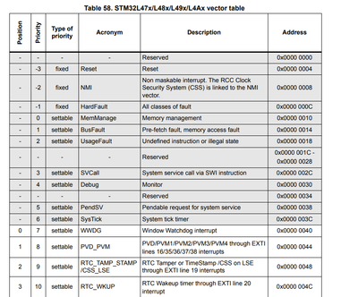

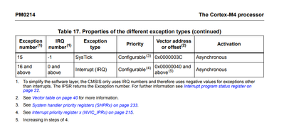

According to 'STM32L47xxx, STM32L48xxx, STM32L49xxx and STM32L4Axxx

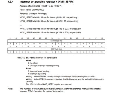

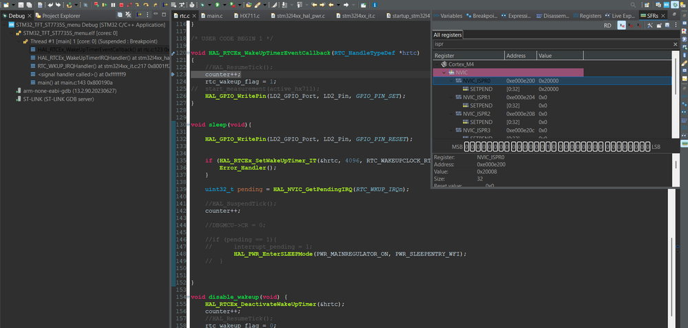

advanced Arm®-based 32-bit MCUs' reference manual and STM32 Cortex®-M4 MCUs and MPUs programming manual, the interrupt pending bit for the RTC wake-up timer should be bit 10 in the ISPR0 register (in the NVIC).
As you can see it isn't set:
However the HAL_RTCEx_WakeUpTimerEventCallback is entered but just in the debug mode:
