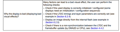

Regarding the attachment, many factors can lead to a bad visual effect, you can try some checks
