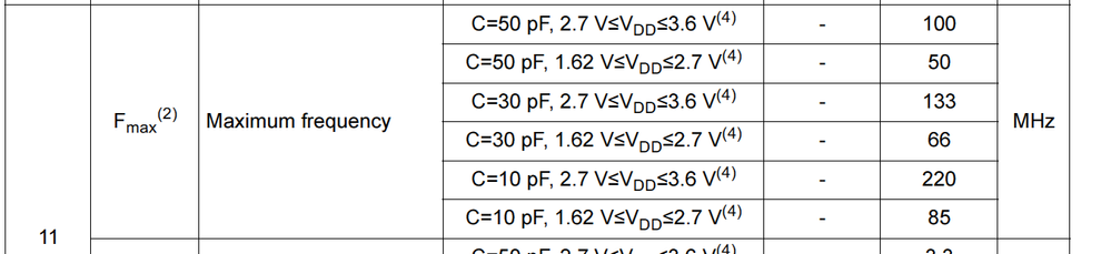

2023-06-07 12:46 AM - edited 2023-11-20 3:47 AM
ON h743 port can up to 220MHz , at 11 power setting:
