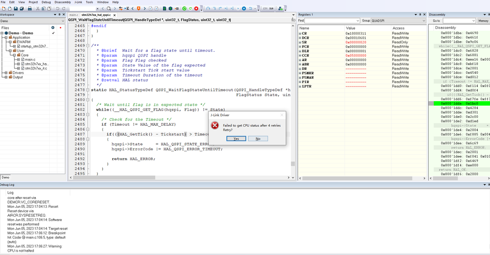

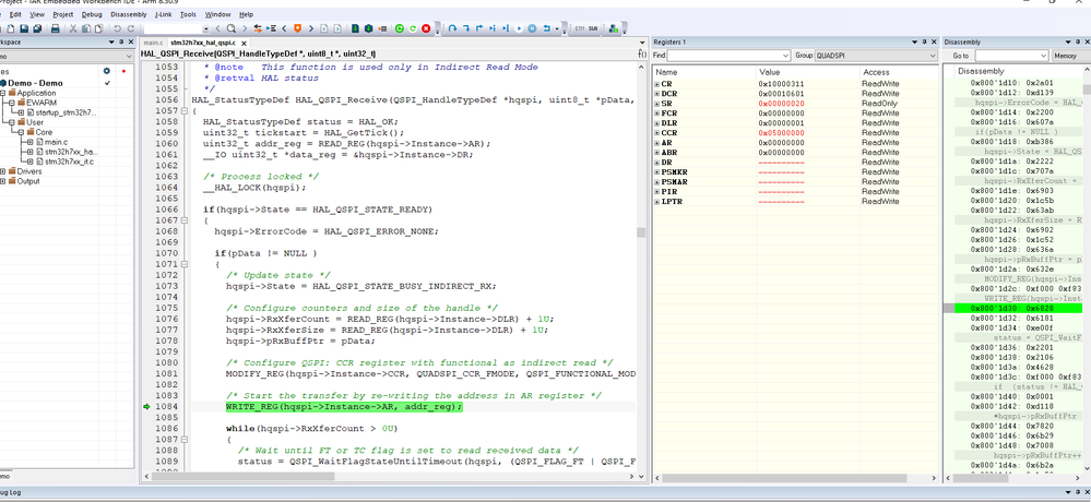

if the DummyCycles = 0,the program is running abnormally.
if the DummyCycles over 2,the program is normally.

if(HAL_QSPI_Command(&hqspi, &sCommand, 5000) != HAL_OK)
return 0;
if(HAL_QSPI_Receive(&hqspi, _pBuf, 5000) != HAL_OK)
return 0;

Are you using the indirect read mode?
It is mentioned in the errata sheet ES03932, for the STM32H743 MCU , when the QUADSPI is configured in Indirect read with only the data phase activated (in Single, Dual, Quad or Dual-quad I/O mode), the QUADSPI peripheral hangs and the BUSY flag remains of the QUADSPI_SR register remains high. An abort must be performed to reset the BUSY flag and exit from the hanging state.
Workaround: Insert a dummy phase with at least two dummy cycles.
Thank you.

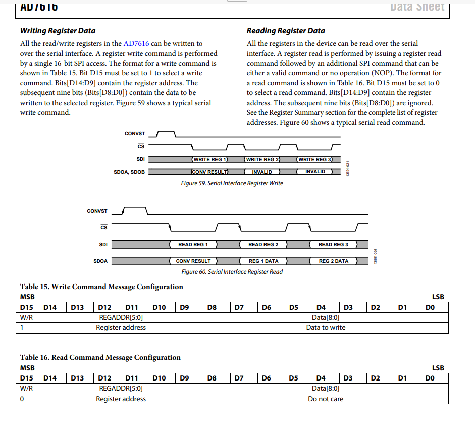

My application uses qspi to communicate with the AD7616 chip,read registers without the need for a dummy cycle。If I increase the dummy cycle, the received data will be abnormal。
When the dummy cycle set 0, the application freezes and needs to be powered off and restarted to emulate。
