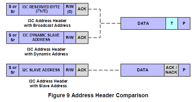

I have a EVB NUCLEO-H503RB and tried to implement I3C Target feature.
Before testing on I3C system, I would like to test some basic read write with legacy I2C Controller.
However, I just found that it seems to be not support with static address on I3C Target feature:
Is there any ways to initialization I3C target with a default address to communicate I2C controller?
Or is there any other MCU series could communicate I2C controller with I3C target features?

Hello @BLAI.1 ,
1) The assignment of the dynamic address is from "Controller ENTDAA" project .
For addressing, an I3C Target Device supports at least one of the Dynamic Address Assignment methods: based on SETDASA, SETAASA, or ENTDAA.
2) You can't set the static address in the Target side for the STM32H5.( if you are working with sensor you can use it's static address for communication )
I recommend you follow the step in the AN and you can try with available examples in the CubeFW :STM32Cube_FW_H5_V1.0.1\Projects\NUCLEO-H503RB\Examples\I3C\I3C_Controller_ENTDAA_IT
Foued

Hello @BLAI.1 ,
From RM "An I3C bus is a two-wire, serial single-ended, multidrop bus, intended to improve a legacy I2C bus."
If you want to communicate an I3C target on I3C bus you can assign an address using Dynamic addressing or define a default static address.
There is no way to communicate I2C controller with I3C target features, you can just work on I3C bus to improve the features of the I2C interface preserving some backward compatibility.
For more details, I recommend you check the Application Note : Introduction to I3C for STM32H5 series MCU - Application note
Foued

2023-06-05 12:30 AM - edited 2023-11-20 4:32 AM
Sorry, I'm a bit confused, what do you mean "assign a dynamic address" in your first sentence?
1) Does it means the configuration from Controller "ENTDAA"?
Or the configuration code in Target itself?
2) How to Initialize I3C Target with a specified address by Target itself?
I tried to modify the initialization code based on ST examples :

3) Reason to have static address on I3C Target
Recently we have some customers trying to upgrade their system with I3C (replacing I2C).
To ensure our components always available on both latest (I3C) and legacy (I2C) systems, we would like to initialize our product with specified I3C Target address before Controller sending any command.
