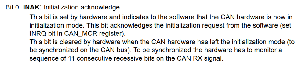

I can understand enabling the CAN1 clock, but the main question I have regarding enabling CAN1 is that the initialization procedure requires reading 11 recessive bits on the CAN RX pin as shown in the screenshot below from RM0430 page 1109. However, the CAN1 RX pin is being used for another peripheral already, so how can the initialization be completed?
2018-12-03 11:15 AM
The CAN peripheral has a loopback mode you can utilize.
2018-12-03 5:05 PM
