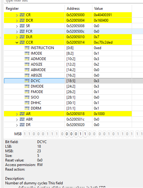

DCYC field in CCR register is 0x3, so there must be only 3 dummy cycles.

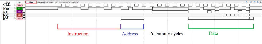

But on time diagram I can see 6 dummy cycles:
So I got 3 extra dummy cycles on STM32H743 board.
My question is: why there are extra dummy cycles? How should I calculate there number?

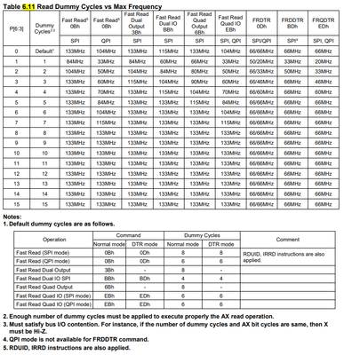

Hello @axlrose21 and welcome to the datasheet;
As mentioned in the memory datasheet, the number of dummy cycles depends on clock speed. Detailed information in Table 6.11 Read Dummy Cycles.
What is the QUADSPI frequency?
Thank you.

I am using 615 kHz and 10 MHz frequencies for QSPI. My flash read register setting are P[6:3] = 0; (default dummy cycles count for Fast Read Quad IO command is 6).
