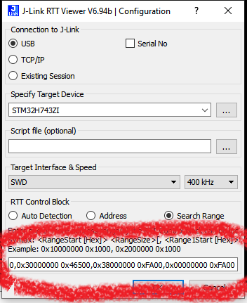

I bought two STM32H743 Nucleo boards recently and did some tests on them. As usual, I first converted ST-Link v2 to JLink interface using the tool SEGGER provided. I have done this with F1, F4, and F7 series boards in order to use JLink RTT for debugging and never had any issue in the past. But when I tried with the new H743 board, I am not able to download the program to the chip using the JLinkExe command line, the way which I usually download programs to STM boards. Even though I can download to the H743 board using the AC3 IDE provided by STM, I am not able to debug after that. Right after the program is downloaded, it run in a wired loop and never be able to stop. Also I am not able to see the RTT debug outputs using the JLinkRTTClient terminal, as usual. I googled a couple of times regarding this question but got no answer.

The solution is simple, define all RAM regions: 0x20000000 0x1F400,0x24000000 0x7D000,0x30000000 0x46500,0x38000000 0xFA00,0x00000000 0xFA00 in RTT_Viewer
