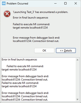

I get an error starting a debug session from STM32CubeIDE (1.18.1) (STM32 Nucleo-F767ZI):
STMicroelectronics ST-LINK GDB server. Version 7.10.0
Copyright (c) 2025, STMicroelectronics. All rights reserved.
Starting server with the following options:
Persistent Mode : Disabled
Logging Level : 1
Listen Port Number : 61234
Status Refresh Delay : 15s
Verbose Mode : Disabled
SWD Debug : Enabled
InitWhile : Enabled
Target USB comms error
Error in initializing ST-LINK device.
Reason: USB communication error. Please reconnect the ST-LINK USB cable and try again.

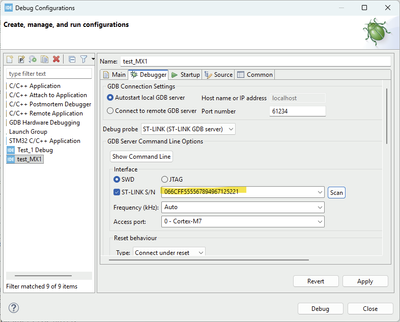

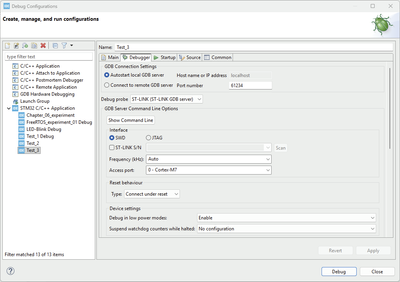

Is my debug configuration:

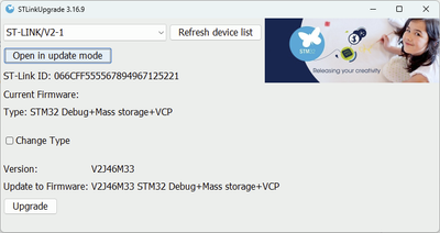

After reflashing the ST-Link debug probe with ST-Link firmware using STLinkReflash, an update by meens of STLinkUpgrade has to be conducted. STLinkUpgrade is a tool inside the CudeIDE (Help->STLinkUpgrade)(screenshot).
I suppose, the STLinkReflash (Segger Tool) ist outdated. Is has version 190812 (2019.08.12). But it is the latest version currently.
After the "uprade" debugging from the CudeIDE works fine. So switching between SEGGER J-Link und ST ST-Link is now possible.

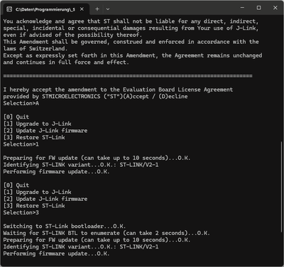

I switch between ST-Link and J-Link with the STLinkReflash-Tool. That works fine. If J-Link is flashed I can start a debug session from the STM32CubeIDE and from the SEGGER-Tools (Ozone, SystemView). But if I change to ST-Link, I get the error.

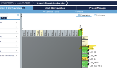

Ensure debug pins (SWDIO, SWCLK) are not assigned to other signals.

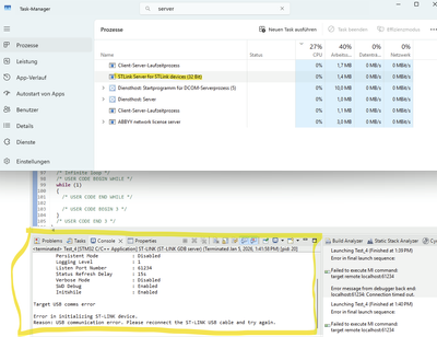

2026-01-05 4:44 AM
I have installed the ST-Link server. I see in the task manger that it is a 32Bit application. I have a 64 bit OS. Could that be a problem?
2026-01-05 4:50 AM

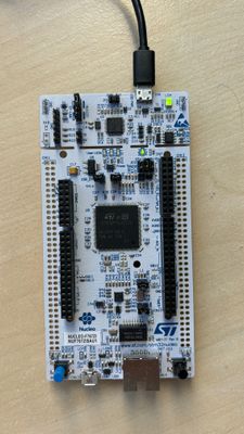

I ganerate the code with CubeMX with default settings. As far as I can see the debug pins are ok. I habe link! When I start the debug session the LED LD4 switches from red to green and then comes the timeout.
