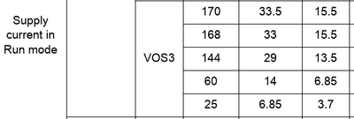

Because the analog sensor needs the ADC to get a value (and added possible error here (need run calibrate on ADC first and set recommended sampling time -- i think you did)) i would prefer the DTS at temp more around ambient.
So just do a check : set the cpu to a very slow clock, to have very low heat /dissipation , and look, what temp its giving then; should be only some degrees above ambient (on the board).
But from ds big tolerance if temp is high , compared to ambient :
The coefficient might be 30% off...so without a calibration this could be more "guessing" at 100° or more.
If clock at 25M , only 4...7mA , at 3v3 about 20mW or less dissipation:
So you could prove , the readed value is close to the real/true temp at ambient temp.
But on the analog sensor you have the stored calibration value for 110° :
So if you want to know the chip temp at high clock + dissipation, this should be the better (really tested on this chip) value, to check chip temperature at around this 110° .
