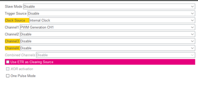

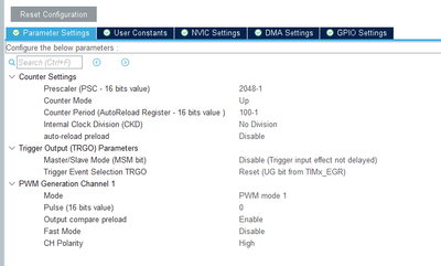

In my old project the Internal Clock was set to 200MHz and this is the configuration of timer 3:
Initing PWM is done like this:
HAL_TIM_PWM_Start(&htim3, TIM_CHANNEL_1);

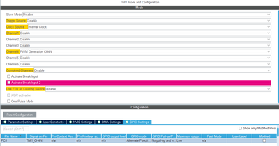

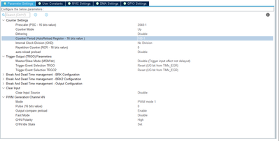

My CubeMX configuration looks like this:
The rest for now remains the same except that I am using TIM1 and TIM_CHANNEL_4 for init an changing the dutycycle, but I do not see any response from the device.

To start channel 4N, you use HAL_TIMEx_PWMN_Start.
Channel 4N is usually the reverse polarity of channel 4, but the details are more complicated.
