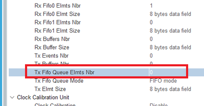

1- I don't see a reason to stop the FDCAN after Init:
if(hfdcan1.State != HAL_FDCAN_STATE_READY){
HAL_FDCAN_Stop(&hfdcan1);
2- From stm32h7xx_hal_fdcan.c:
if (hfdcan->State == HAL_FDCAN_STATE_BUSY)
/* Check that the Tx FIFO/Queue has an allocated area into the RAM */
if ((hfdcan->Instance->TXBC & FDCAN_TXBC_TFQS) == 0U)
/* Update error code */
hfdcan->ErrorCode |= HAL_FDCAN_ERROR_PARAM;
return HAL_ERROR;
-> As you can see in the comment, you didn't allocate memory into RAM for Tx messages.
You removed the FDCAN Init from the main.c you shared but according to CubeMx Fifo elements number = 0:
You need to set it at least to 1.

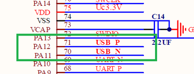

I attached the schematincs of the board. There is a mistake regarding the pins connected to the canbus peripheral. The correct pins are PA11 and PA12 like the default configuration of FDCAN1 from STCubeIde

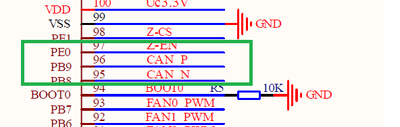

According to the schematics, you need to use PB8/PB9 (connected to the tranceiver which is not necessary in LoopBack mode) instead of PA11/PA12 as the latter are used by USB and may external components force the IO levels of the MCU.

As I mentioned there is a mistake in the schematics. The pins used for CANbus and USB are swapped
So in the actual board pins PA11/PA12 are actually used for CANbus and PB8/PB9 are used for usb.
We verified this and are 100% sure

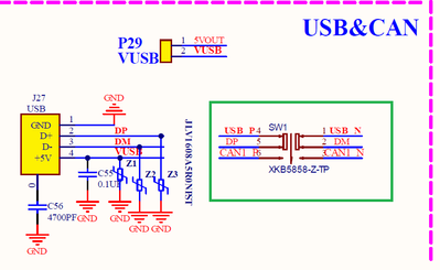

Ok, in that case, check this part of schematics with that mechanical switch:
This is not clear to me how it's configured (with the mistake you mentioned). But you need to ensure there is nothing disturbing Tx and Rx pins externally.

We didn't design the board, that should just be a jumper to ouput to a type-A usb connector either the canbus or a serial. Activating or deactivating it does not change anything
return HAL_ERROR;
You didn't design the board but you need to ensure that there is nothing disturbing the Tx and Rx externally and it's up to you to fit/remove the jumper according to this request.

It looks like the cause of the 0x20 error was that we didn't allocate any memory for the tx messages as you pointed out
