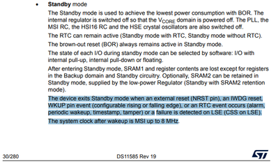

Hello @saikumar31 and welcome to the ST Community.
As you can see on the DS11585 Rev 19 page 30:
"The device exits Standby mode when an external reset (NRST pin), an IWDG reset,
WKUP pin event (configurable rising or falling edge), or an RTC event occurs (alarm,
periodic wakeup, timestamp, tamper) or a failure is detected on LSE (CSS on LSE)."

@STTwo-32 wrote:As you can see on the DS11585 Rev 19 page 20:
you mean page 30?
https://www.st.com/resource/en/datasheet/stm32l496ae.pdf#page=30

As mentioned on the paragraph I shared with you. The PC13 should be configured as a Wake-up pin to wake up the MCU from standby mode. EXTI is not a source of Wake-up.
