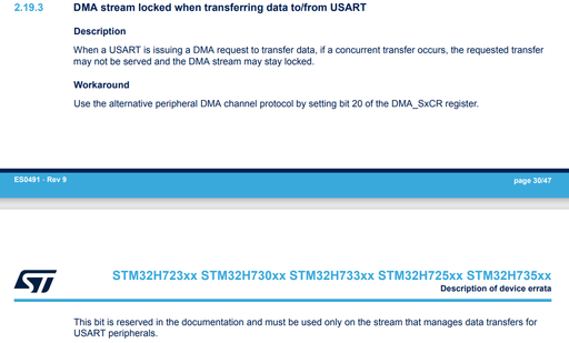

Hello @peter_zhly and welcome to the community;
Do you have the same issue when all USART are disabled?
Could you please check if this errata is respected or not in your project code?
Thank you.
