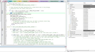

In mem_malloc, the program fails at:
/* Scan through the heap searching for a free block that is big enough */
for (ptr = mem_to_ptr(lfree); ptr < MEM_SIZE_ALIGNED - size;
ptr = ptr_to_mem(ptr)->next) {
mem = ptr_to_mem(ptr);
Although mem is allocated with the LWIP heap pointer address successfully, at the same time, ETH->DMAErrorCode reports 0x4080.

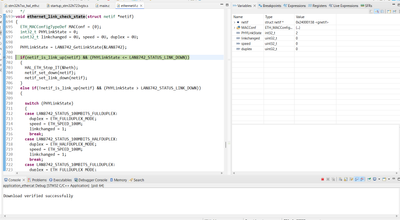

I have checked the addresses of the related buffers:
DMARxDscrTab: 0x30000000
DMATxDscrTab: 0x30000100
memp_memory_RX_POOL_base: 0x24003460
In lwipopts.h I configured:
#define LWIP_RAM_HEAP_POINTER 0x30000200
#define MEM_SIZE 32232

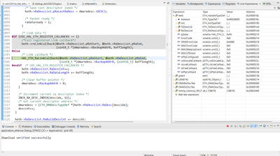

When I set a breakpoint inside HAL_ETH_ReadData, the execution reaches HAL_ETH_RxLinkCallback but then fails with a DMAErrorCode.
If I do not set any breakpoint, there is no error, but the board does not respond to pings.
From Wireshark, I can see that the PC sends ARP requests to the STM32, but the STM32 does not reply.

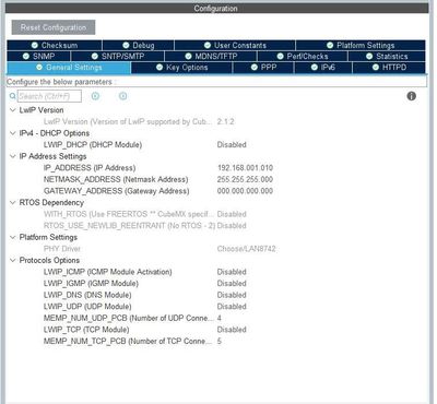

My LWIP network configuration is as follows:
IP_ADDRESS: 192.168.1.198
NETMASK: 255.255.255.0
GATEWAY: 192.168.1.1
On my PC I am using:
IP_ADDRESS: 192.168.1.68
The firewall on the PC is disabled.
