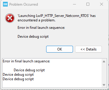

If I try to debug the project, I get this message:
What am I doing wrong here? The example should work out of the box, correct? I did not change the jumper configuration of the board out of the box. JP6 and JP7 are installed.

Hello @chris1seto and welcome to the community,
The problem is not reproduced with the latest version of CubeIDE. Could you specify which CubeIDE you are working with?

2024-07-10 11:31 AM
Oops, this one is on me. I have a lot of Nulceo-144's on my bench and I simply grabbed the wrong one, an F7. It works now with the correct H7 attached. They all look the same!
Thank you @Rim LANDOLSI

Yes, the debug session for this example is started successfully with CubeIDE 1.16.0.
