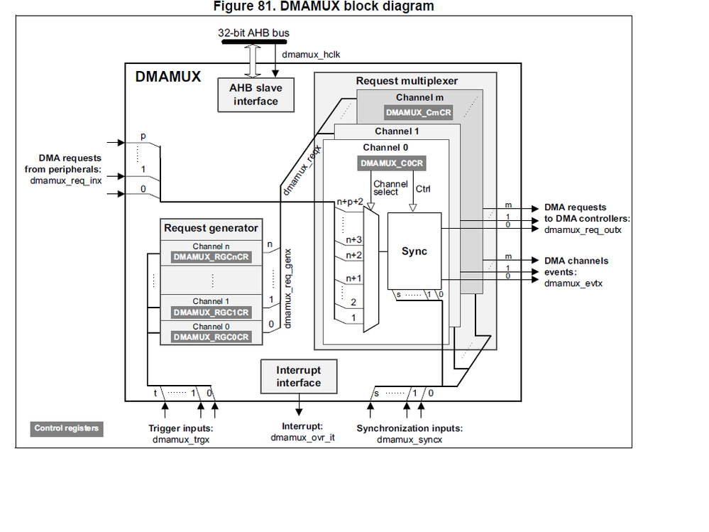

The block diagram - copied below
Seems to indicate that we can have a DMA_REQUEST from peripheral not processed until a Synchronization input is present.

}I was basically telling the DMA subsystem to not start the SPI2_TX DMA transaction until the exti input goes from high to low.. - is that not the case?
What is interesting is that with the above setup if I manually toggle bit PR1 in register CPUPR1 the transmission happens (in fact I can toggle any bit but PR0) in the CPUPR1 register and the SPI transmission is initiated... - Obviously the intent was to have the PR0 flag automatically trigger the TX but that does not occur...
I think what you are suggesting is setting up the DMAMUX request generator and using the EXTI input as a trigger to write to the SPI TXDR register directly? - That could work but I am a bit confused as to why the above setup should not work especially since the block diagram seems to indicate that this scheme is feasible - but again as I mentioned initially I am still confused on exactly how the DMAMUX works and the empirical results I am getting are confusing me even more...

I misunderstood your - you indeed appear to need the synchronization feature of DMAMUX.
I don't use the 'H7 nor DMAMUX, but I doubt there are many users here who do (other than using the straightforward request mapping).
I also don't use Cube. I believe in this case you should also stop talking in terms of Cube/HAL and start discussing directly registers content.
How? You can only clear bits in CPUPR1, its bits are rc1.
But, as you write the register (and register bits can't be written alone, hardware always writes at least a byte) there may be some mechanism in hardware which generates an edge on the output signal which then goes into DMAMUX. This is not well described in the manual (as I wrote above, it's not clear at all what the signal which goes into DMAMUX really is).
But talking about EXTI_CPUPR1, you should be able to *see* that the selected edge occured, that should set this register's bit 0. You should be also able to set it indirectly by setting the respective bit in EXTI_SWIER1.
As an experiment, you can also enable the respective EXTI0 interrupt and write a simple ISR for it to check it is working - e.g. toggle a pin observed by LA.
That in turn should generate the required edge in the synchronization input of DMAMUX. Check the respective DMAMUX1_CxCR register, if the proper SYNC_ID and proper DMAREQ_ID (i.e. the number corresponding to SPI2_TX) is set in it.

> both rising & falling edge require the ISR to be enabled -
I did not expect this to go away - as the DMAMUX synchro is edge-driven, there must be something which clears the pending exti0-interrupt signal, so that the next edge could be generated. I expected to see the interrupt-caused latency to go away with the opposite polarity.
To avoid the interrupt yet still clear the pending interrupt, you could perhaps use another DMAMUX channel to generate a DMA from the same exti0-interrupt, which would write the appropriate constant into EXTI_CPUPR1 clearing the pending interrupt.
Or, use the workaround outlined by berendi above.
