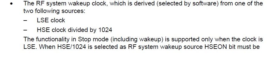

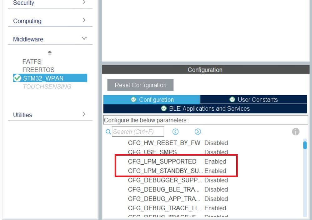

Hi @Community member ,
Could you please check your project's low power configuration? It should be disabled if you select HSE/1024 as RF system wakeup clock.
I do not know which specific device you are working on, but just as an example, you can find the information in RM0434 Reference manual of STM32WB55 at page 204/1530.
