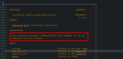

We are using a composite USBX device class combining CDC and MSC over USB Full Speed, built on X_CUBE_AZRTOS-H7 version 3.3.0 (USBX 6.4). During testing we discovered that a certain Windows PC sends a MODE SELECT(10) command (opcode 0x55) and causes an endpoint stall.
After a rather long debugging session, it was found that the USBX source _ux_device_class_storage_mode_select() is explicitly not implemented — it stalls the OUT endpoint, UX_FUNCTION_NOT_SUPPORTED (which is not checked in the thread) and never recovers:
The MODE SELECT(6) SCSI command is not even implemented and the storage thread falls through to the default case, also triggering a endpoint stall.
So:
- Are there any plans to implement these MODE SELECT(6/10) commands properly in a future USBX release?
- Does anyone already have a workaround for this?
- Wouldn't it be cleaner to reply with an ILLEGAL REQUEST instead of stalling the endpoint?

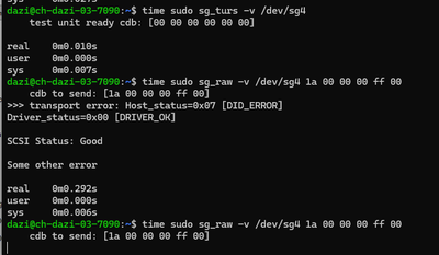

I already created once a sample project for the NUCLEO-H753ZI. With this project, the issue cna be reproduced and the code is available on github: https://github.com/NoyzZimmi/STM32H7_MSC_CDC
The above project is directly based on the sample project:
https://github.com/STMicroelectronics/x-cube-azrtos-h7/tree/main/Projects/STM32H735G-DK/Applications/USBX/Ux_Device_MSC
I don't have this development kit, but since the problem seems to be with USBX implementation, it probably can be reproduced directly with that sample project.
To reproduce the issue you can follow the steps below. If you are working on Linux, it is even simpler:
Optional step on Windows: open Power shell with Admin rights:
  1. Install usbipd
  2. usbipd list -> identify the bus ID
  3. usbipd bind --busid 6-7 --force -> this binds the port
  4. usbipd attach --wsl --busid 6-7 -> will attach usb port to WSL and start a server
On Linux / WSL (i choose ubuntu):
  1. lsusb -> identify you device
  2. dmesg | tail -20 -> also helps to find the device, for me it is /dev/sg4:
    2026-03-25 18_08_28-TmpWorkspace - STM32H7_MSC_CDC_Core_Src_main.c - STM32CubeIDE.png
  3. time sudo sg_turs -v /dev/sg4 -> will send a test message and should repport that a SD card is present
  4. time sudo sg_raw -v /dev/sg4 1a 00 00 00 ff 00 -> this will break the MSC and the device is not responding anymore
The second request with SCSI command 0x1A will never complete and the endpoint stalled and does not recover.
Best regards
Daniel
