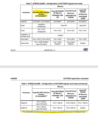

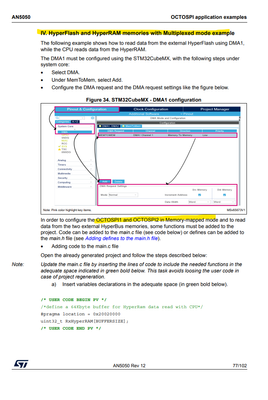

Hello;
An HyperFlash and HyperRAM memories with Multiplexed mode example is available in AN5050.
Thank you.

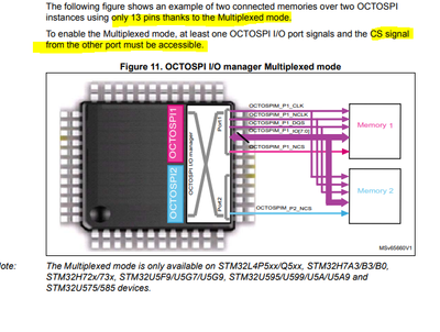

Hello @WA and welcome to the community;
To enable the Multiplexed mode, at least one OCTOSPI I/O port signals and the CS signal from the other port must be accessible s explained in the below figure from AN5050

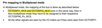

So, Multiplexed mode requires BOTH: OCTOSPIM_P2_NCS and OCTOSPIM_P1_NCS
as mentioned in the RM0468:
OCTOSPIn_NCS are not part of the multiplexing. Only OCTOSPIn_IOs, OCTOSPIn_DQS and OCTOSPIn_CLK / OCTOSPIn_NCLK are multiplexed.
When referring to the STM32H725 datasheet, you can find that the STM32H725ZGT6 supports the multiplexed mode. The OCTOSPIM_P1_NCS is available on PB6 and OCTOSPIM_P2_NCS is available on PG12 pins for STM32H725ZGT6.

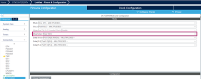

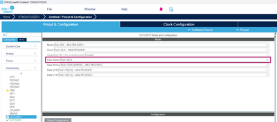

You can used the STM32CubeMX to enable the multiplexed mode.
