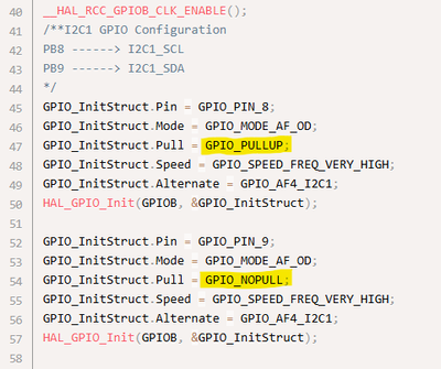

__HAL_RCC_GPIOB_CLK_ENABLE();
/**I2C1 GPIO Configuration
PB8 ------> I2C1_SCL
PB9 ------> I2C1_SDA
GPIO_InitStruct.Pin = GPIO_PIN_8;
GPIO_InitStruct.Mode = GPIO_MODE_AF_OD;
GPIO_InitStruct.Pull = GPIO_PULLUP;
GPIO_InitStruct.Speed = GPIO_SPEED_FREQ_VERY_HIGH;
GPIO_InitStruct.Alternate = GPIO_AF4_I2C1;
GPIO_InitStruct.Pin = GPIO_PIN_9;

2025-06-19 9:02 AM
It looks like you have internal pull-up enabled for SCL, but not for SDA. Hopefully you're not relying on internal pull-ups and that you indeed have external pull-ups. If not, use 2 resistors on both SCL and SDA. ~4.7K is typical value to start with.
