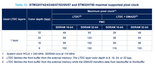

I have I project (STM32H743IIT6) and I want to know if it's possible to have use a display 1280x800 24bpp? if it's not possible can I still have a display with a resolution of 1280x800 but with les bpp? Can I use a different MCU STM32H757XIH6 or another?
Thank you

Hello @aabba.1 ,
Could you please refer to AN4861 precisely Table 12 and check the maximal supported pixel clock:
Pixel clock = Total Width x Total Height x refresh rate.

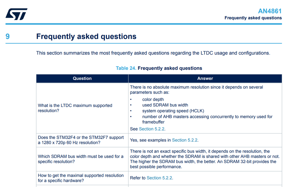

Please take a look at 9 Frequently asked questions in AN4891 may help you.
Please let me know if your request is answered or not?
