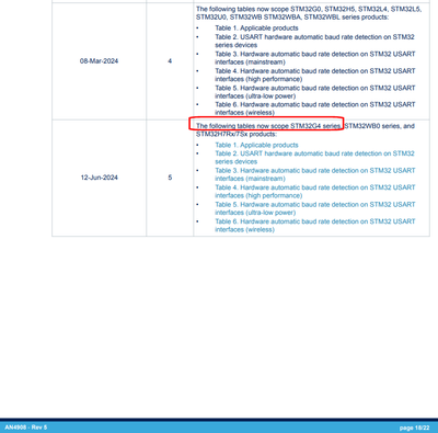

@Jaroslav JANOS wrote:
you can check the application note AN4908: https://www.st.com/resource/en/application_note/an4908-stm32-usart-automatic-baud-rate-detection-stmicroelectronics.pdf
The G4 serie is not mentioned there,
That was July last year.
2024 updates have added G4, among others:
