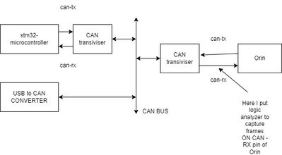

To clear the above points I also adding the block diagram of my system.

Hello @skhanna
My first question is: what is the clock source of FDCAN? if you are using cubeMx please attach your ioc file.
2024-08-20 3:28 AM - edited 2024-08-20 3:31 AM
Thanks for reply,
I am using the external 8 MHz crystal oscillator available on NUCLEO-H753ZI. and sorry IOS file is not available. CAN frequency is 50MHz.
PLease see this for more clarity–All device are connected as shown in my previous post figure.

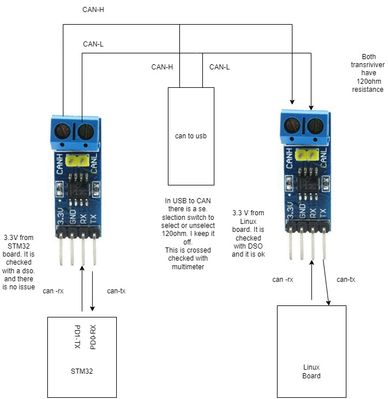

2024-08-20 3:37 AM
It's not easy to determine what the problem is in such kind of situation. You need to provide more details:
- STM32H7 schematics including the transceiver connections. We need details on this part.
- What about the the termination resistors? As you are using two other nodes "Orin NX" and "CAN to USB bridge", are you sure you have only two 120 ohm resistors on the both termination of the bus?
2024-08-20 3:44 AM
As you ask...
1) only two 120 ohm resistors on the both termination of the bus?-- Yes I also check the communication by connecting linux board and STM32 board only, at this time USB to CAN is not connected. Error is still coming and as I say i am able to receive on USB to CAN controller so I think hardware connection are correct. Please first cross check the STM32 driver I share in my post
2024-08-20 3:46 AM
Sorry, you need to provide your HW details before: STM32H7 schematics including the transceiver connections.
2024-08-20 4:11 AM
This is link of transriciver
This is for USB to CAN converter
https://www.waveshare.com/product/usb-can-a.htm
