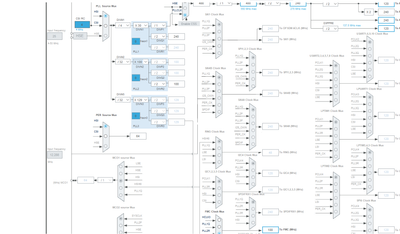

The clock options are more complicated than just SDRAM clock = SYSCLK / prescaler. You should be able to find one at which SYSCLK=480 and SDRAM=100 by using the clock mux.
You don't mention which chip you're using, but here is one such configuration:

Okay, so you should be able to find a solution using the clock mux. The screenshot I posted is relevant for the STM32H743.

I was successful to set 99MHz.
Thank you so much
