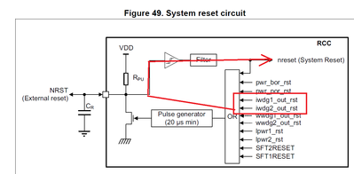

2025-12-16 8:53 AM - edited 2025-12-16 8:58 AM
From RM0399:
2025-12-16 8:18 AM
They pull NRST low which will reset both cores.
From RM0399:
2025-12-16 9:24 AM
Correct. All reset sources are routed to NRST which resets the entire chip. Literally the same effect as holding the reset button down.
