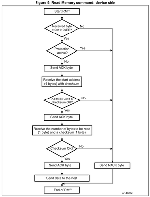

The UART bootloader protocol is given in AN3155.
USART protocol used in the STM32 bootloader - Application note
The chip will reply to whatever command it is sent.
In the read memory command, the STM32 does not echo back the command (0x11). It just ACKs (or NACKs)
