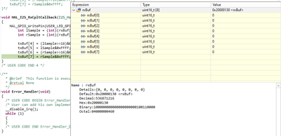

No data stored:
As you can see, I have no data in the buffer. I've checked clocks and data line with scope and it's okay here. The DMA interrupt also fires, but requires I-Cache enabled. So what can I do with it?
