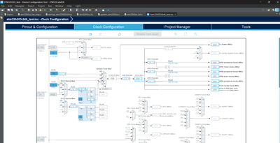

I am using STM32H503CBT6 with a frequency of 250MHz, but my program is not running. I have a counter variable in a while loop, but it is not incrementing. When I lower the frequency to 100MHz, the program works. Please help me!

Are you sure about your clock config? what about the Flash wait states value?
Could you please share your project? What board are you using?

I only changed my clock config and the counter variable does not increment. Help me!

You didn't answer my two questions:
1- What board are you using? if not ST board please share the schematics.
2- What Flash wait states you set?
Please attach your ioc file.
