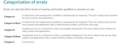

We received that recently from our partner ARM and now we are analysing the impact of this Category C (minor error) on our Customers.
I've escalated your request internally for more investigation (under internal ticket number  183817) and we will be back to you with more details ASAP.
