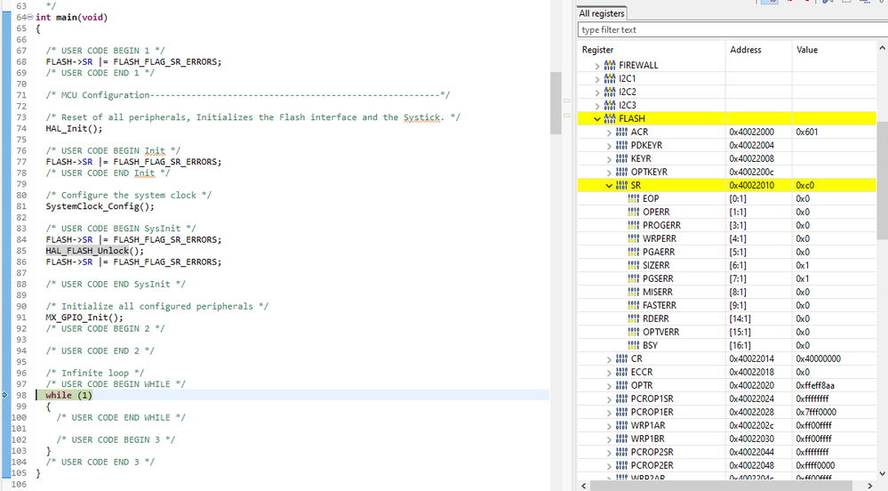

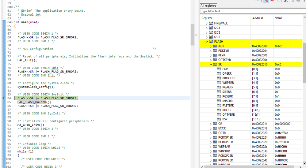

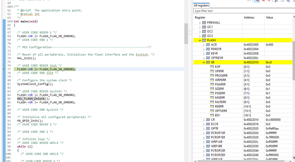

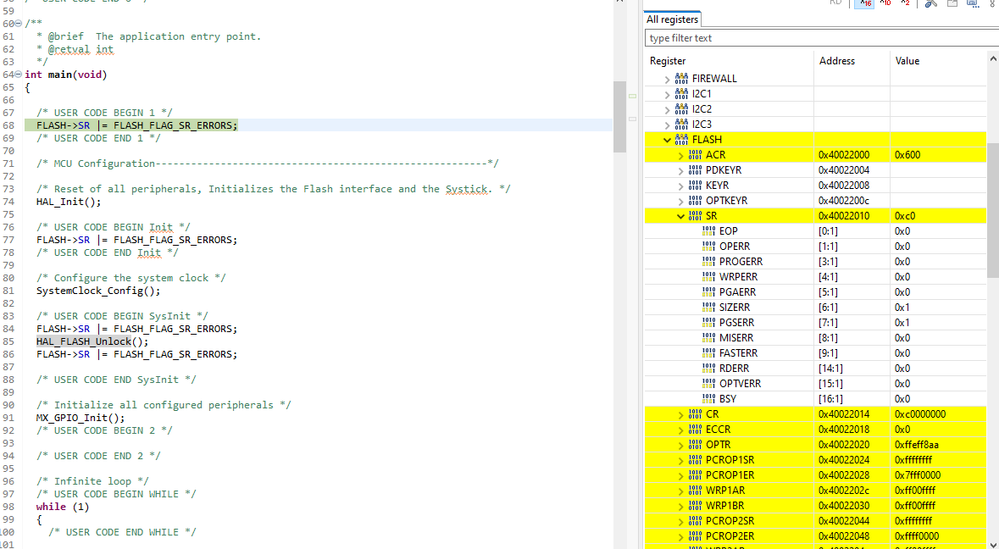

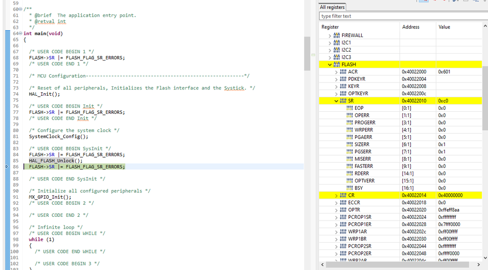

I am using STM32L476ZG MCU development board. I created a new project without adding any interrupts. I noticed that FLASH->SR = 0xC0 at reset and when I try to clear it, it comes back after the next command I execute.
I'll add screen shots to clarify what I am experiencing.
1- Just entered the code, no command executed yet

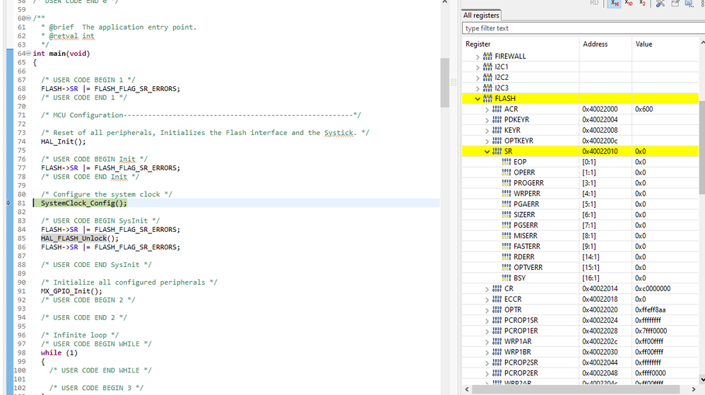

2- executed `FLASH->SR |= FLASH_FLAG_SR_ERRORS;`

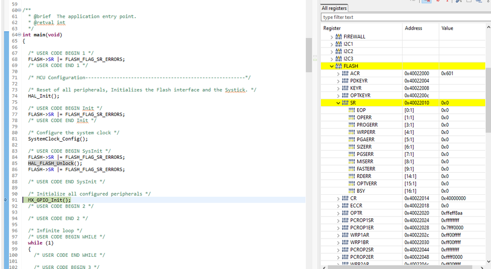

3- executed `HAL_Init();`
4- executed `FLASH->SR |= FLASH_FLAG_SR_ERRORS;`
5- executed `SystemClock_Config();`
6- executed `FLASH->SR |= FLASH_FLAG_SR_ERRORS;`

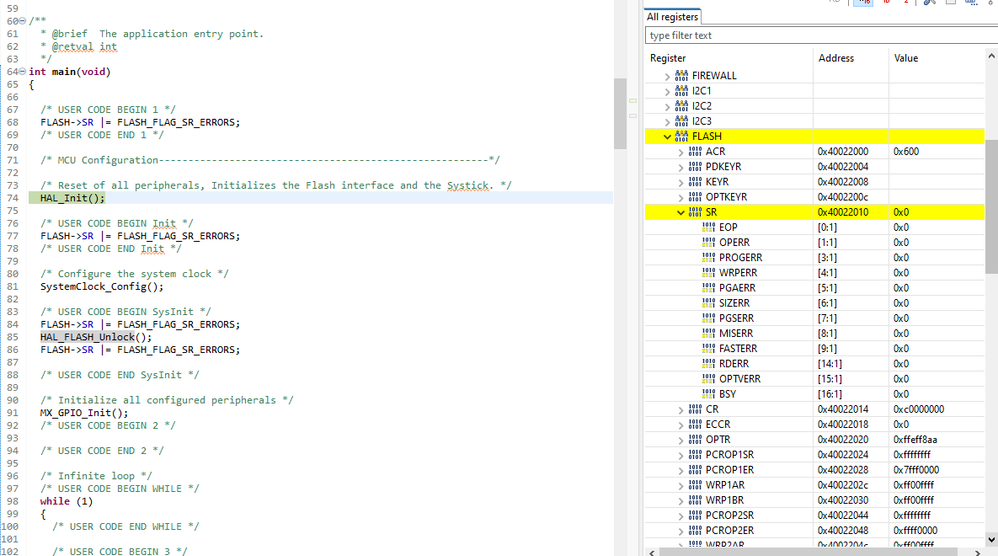

7- executed `HAL_FLASH_Unlock();`
8- executed `FLASH->SR |= FLASH_FLAG_SR_ERRORS;`

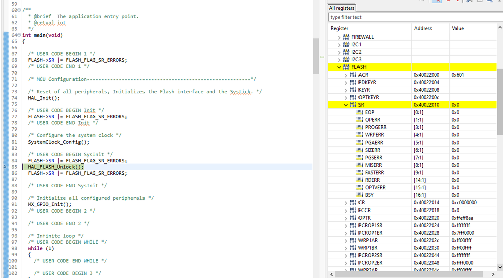

9- executed `MX_GPIO_Init();`
You can see I failed to permanently clearing FLASH-SR

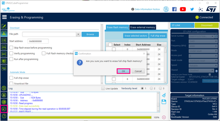

Hello @Namir  and welcome to the Community :),

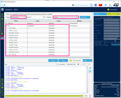

Could you please try to connect your board using STM32CubeProgrammer.
Then, click on erase flash memory and check the status of Flash_SR register as shown in the below figures.
Also, could you please try this example STM32CubeL4/Projects/NUCLEO-L476RG/Examples/FLASH/FLASH_EraseProgram at master · STMicroelectronics/STM32CubeL4 · GitHub and check the FLASH->SR reset value.
I hope this help you to solve the issue.
