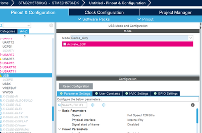

This chip does not support OTG because there is no ID pin (nor does it have the underlying hardware support). Because of that, you won't find any OTG options in CubeMX for it.

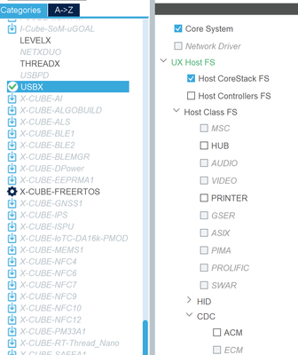

To enable it as a USB host, select host in the USB tab and then configure it in the USBX tab. Seems to be working okay in CubeMX. USBX is the supported USB framework for this chip.

Also, as mentioned @TDK , STM32H5 supports USBX natively instead of ST USB library. Here examples of classic library if needed. USB_Device MW is not supported by CubeMX. So, the point is code generation is allowed only using the USBX stack.
Q2:Would you attach IOC file if you confirm USB Mode is not configurable
