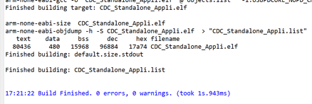

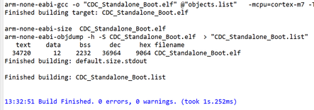

> CDC_Standalone
> Nucleo-H7S3L8 board
If I try this example via the Example Selector in STM32CubeMX, it generates the project and compiles just fine (both boot and application). Make sure you change the toolchain to STM32CubeIDE. Click "Generate Code" then "open project" when it completes.
Maybe try loading the project that way. Toss the tutorial.

2026-03-24 3:33 PM - edited 2026-03-24 3:35 PM
Windows. Latest versions of STM32CubeIDE and STM32CubeMX. Can you zip up your project and attach? Are you on updated versions? (though it should work fine in previous ones as well)
Should look like this in the explorer:
Are there spaces or non-ascii characters in the path?
