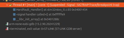

I've tried following both, but it seems to hardfault on both examples crash at __lib_init_array(). I've tried increasing the stack and heap sizes to no success:

When I connect the USB, my computer does not detect any device. I noticed that the USB1 OTG HS interrupt was not enabled, but enabling it causes a hard fault.
For context, I am running the project using an FSBL load-and-run configuration. The hard fault appears to occur when the FSBL attempts to jump to the application. Specifically, it happens during the application startup, at the bl __libc_init_array. My heap and stack are configured to 0x300 and 0x4000, respectively.

I've followed various tutorials and forum posts already to set up the FSBL load and run configuration. I don't believe its that. Its when I add my USB library in everything hardfaults and crashes, specifically in the application project startup file at bl __libc_init_array.

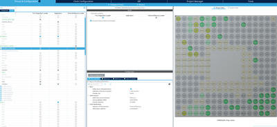

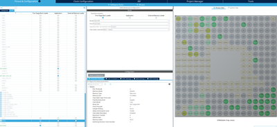

For sake of thoroughness, I'll go through everything I've done so far in terms of setup:
Device: STM32 - Nucleo-N657X0-Q
RCC:
HSE: Crystal/Cermamic Resonator (Uses default 48MHz OSC)
LSE: Disabled
XSPIM:
Runtime context: FSBL
Mode: Direct (XSPI1 to Port1; XPI2 to Port2; XSPI3 not used)
XSPI2:
EXTMEM_MANAGER:
EXTMEM_LOADER:
USB1_OTG_HS:
Runtime Context: Application
Speed: Device HS 480MBits/s
Physical Interface: Internal HS Phy
Ref Clock Selection: 24 MHz
Everything else disabled.
Clock Configuration:
XPI2 Source Mux is set to IC3 @ 50MHz
To OTGHS1 is set to 48 MHz. I've seen forum posts for the H5 say to set this to 60MHz, but I can't seem to set it to that value.
For both CORTEX_M55_FSBL and CORTEX_M55_S, the I and D cache are disabled for now, as well as the MPU.
