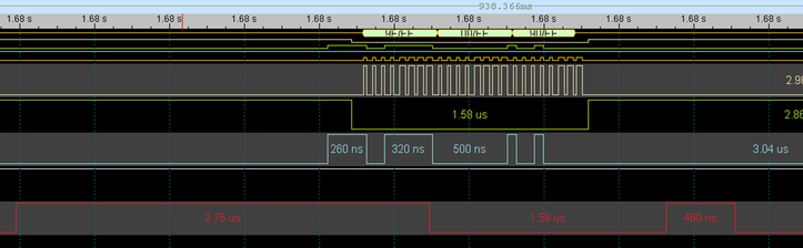

I’m new to using the STM32H563 solution. To send SPI data using DMA, I referred to the sample code from the SPI DMA sample of the H533RE project.
I'm not sure when exactly the SPI is start to transfer the data by DMA.
The following is a part of my test code and the analyzer result.

Analyzer result:
1. In my code, I didn’t use LL_SPI_SetTransferSize. I’m curious about the difference if I were to set LL_SPI_SetTransferSize. Would any register change after the SPI sends the frame count we set earlier?
2. Is there a reference document related to the ping-pong buffer for STM32H5 SPI DMA?
3. In my code, it appears that the SPI starts to transfer data before I set CR1_SPE and CR1_CSTART. What exactly is the SPI DMA start bit for transferring data via DMA?
Thanks.
