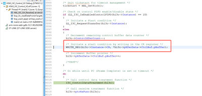

My I3C target don't send ACK after controller send an arbitration header ,and it will generate a DOVER flag and ERRF flag.
ex.
Send HAL_I3C_Ctrl_IsDeviceI3C_Ready before controller transmit data.
Send HAL_I3C_DIRECTION_READ
and so on

I can enter I3C interrupt handle.But it will generate a HAL_I3C_ERROR_DOVER or HAL_I3C_ERROR_SIZE failed.

When the controller send this command, the target will report HAL_I3C_ERROR_DOVER code.
2024-03-11 6:37 PM
And when the dynamic address of the target does not match,it will not respond to this command.
