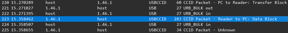

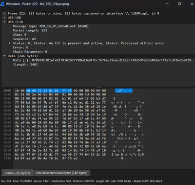

The issue that I face, the PC finishes receiving data immediately after receiving 256 bytes (10 bytes of header + 246 bytes of data). when I want to send to pc 253 bytes of data + 10 bytes of header (263 bytes in total) by splitting (64 bytes by 64 bytes) the PC finishes receiving data immediately after receiving the fourth chunk which is 256 bytes (10 bytes of header and 243 bytes of data), It doesn't wait for the fifth chunk, which carries the remaining 7 bytes of my data which arrives in an unknown message despite the fact that I define the size of the data to be sent as 253 bytes. Images 1 and 2 show these details captured by wireshark software.1
