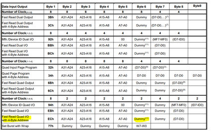

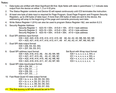

Hi @zeboss49 ,
Could you please check the dummy.
As mentioned in the memory datasheet for Fast Read Quad I/O with 4-Byte Address (ECh), the first dummy is M7-M0 should be set to FFh.
Thank you.
Kaouthar

2024-04-26 12:07 AM
Thank you for your reply.
The dummy byte (alternate byte) and dummy cycles are set according to the device data sheet.
