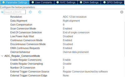

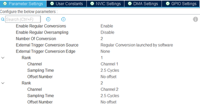

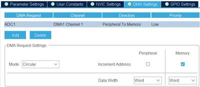

When I configure ADC1 to read voltage input from PA0 and PA1 using DMA, then the behavior is as below in each condition
1) PA0 = 0 (GND) ; PA1 = variable pot (0-5V)
then PA1 provides values as per input from pot but max value displayed in 3022 instead of 4095 while PA0 shows value as 0
2) PA1 = 0 (GND) ; PA0 = variable pot (0-5V)
then PA0 provides values as per input from pot, max value displayed in 4095 while PA1 shows fluctuating values
3) PA0 = 1 (5V) ; PA1 = variable pot (0-5V)
then PA1 provides values as per input from pot but max value displayed in 3022 instead of 4095 while PA0 shows value as 4095
4) PA1 = 1 (5V) ; PA0 = variable pot (0-5V)
Kindly suggest how to solve this issue? Configuration settings of ADC and DMA are attached for your reference.
