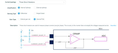

Hello everyone, I am currently working on a fully isolated motor driver using an STM32G474RE. I need to interface the AMC1301differential output to the MCU in a way that ensures accurate measurements. What is the best approach to achieve this? Also in mc workbench app, MCU opamp -> ADC hardware variant for Current sense -> InternalOpamps -> Differential -> InternalPGA. Or I will make the diff to single like in other picture wich looks easier. Also looks same with design below.

if I use amc1301 and diff mod of MCU , then what I will choose these numbers. for example
Polarization offset -> 1.44? because 0 current mean amc1301 produce 1.44 V for each out, PGA = 0. what about offset network attenuation?. Or I will choose to convert to diff to single line and direct to MCU . I already know about that. But diff mode advantage is two line can travel more in PCB without problem

I think we can use it, 1.44 polarization, 1 is offset network attenuation, but I want to be sure,because design is expensive no chance for mistake, I need an approve
