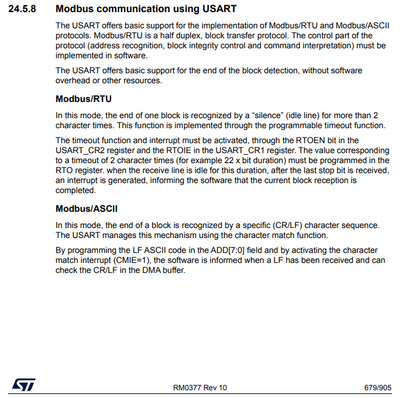

We know that Modbus-RTU is a UART link, but we found that some MCUs(For example:STM32L031K6) supporting Modbus have 2 register-bits for the Modbus mode. They are RTOEN and RTOIE. Refer to the Reference Manual, these 2 bits need to be set to activate. But we couldn't find the same register-bit in STM32F030's document.
Can we achieve the function by software without the register-bit? Are there some knowhow documents about this issue?

We found that some MCUs(For example:STM32L031K6) supporting Modbus have 2 register-bits for the Modbus mode. They are RTOEN and RTOIE. Refer to the Reference Manual, these 2 bits need to be set to activate. But we couldn't find the same register-bit in STM32F030's document.

@PacteraHW2018 wrote:We found that some MCUs(For example:STM32L031K6) supporting Modbus have 2 register-bits for the Modbus mode. They are RTOEN and RTOIE. Refer to the Reference Manual
Indeed:
But, as @jlag said, that's just a "nicety" - nothing that you couldn't also achieve using other standard means.
